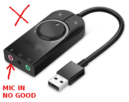

You can easily convert cassette to mp3, if you use the correct inputs.
It’s actually a 2 step process as Audacity will record in 32 bit samples, then you export as mp3 in whatever bitrate you want.
Audacity will not record directly to mp3.
Use an external USB interface (with Line input, not mic) or your computer’s Line inputs.
If you use the mic input, you will just be wasting time and will not be satisfied with the results.
Below, two types of USB audio interfaces (in both cases, I have obscured their names as I’m not in the advertising business).
The first is no good:
The one below, is one of several that will work for your purpose:
