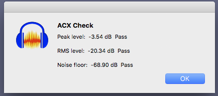

Here is a raw sample recording. I’d like to know what others hear in it - background noise/siblance/mouth noise/loudness… It’s a new mic I am using - Rode NT1 - and i am working on mic placement right now.

I applied the Audiobook-Mastering-Macro and it passes the ACX-Check technical conformance straight out of the gate. Congratulations.
However, passing the electronic standards is only the first step. Now you have to be an actor. You sound like you’re not quite sure of the dialog and you’re not exactly happy to be here. That’s the kiss of death for a voice performer.

I’ll take that as there was no siblance or mouth noise.

Some sibilance is a necessary, otherwise necessary => nethethary.
Only if sibilance is excessive is de-essing required.
IMO you need a little bit of de-essing …

I didn’t hear anything that could be flagged as “damage.” I’m listening on a killer sound system which occasionally can be a problem. Someone listening on fashionable headphones or much smaller sound systems can have emphasis on some vocal tones over others. Listening to your work is a really big deal. Doing it while you’re performing can solve a lot of problems. Highly recommended.
