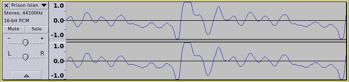

There is some distortion in the “bad example”. Something is being overloaded - either the recording level is too high, or you are too close to the microphone, or you’re getting excited and talking too loud, or you have pushed up the level too high when editing, or …
See the flat top to the waveform in the selected area - the top / bottom of the waveform is cut off:
Prior, I had my input volume set to 0.4, now I have it at 1.0 just simply because 0.4 since I removed the trojan is way too quiet.
And sorry I didn’t understand the image, could you dumb down your suggestion to me?
I have downloaded the Prison Island video and imported the audio into Audacity.
Zooming in really close at about 3 minutes 17 seconds:
See how the waveform is so big that it does not fit in the track - the top and bottom of the largest peaks are being “chopped off” (clipped) and this causes audible distortion.
