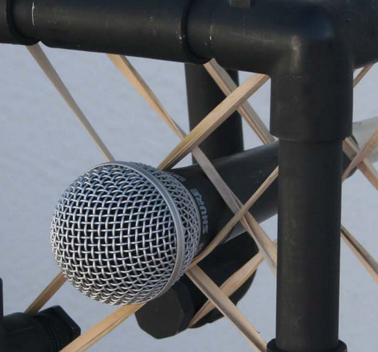

Probably not. Unless you have a Specialty Recording Problem such as Drums, Landing Aircraft, Windy Beach, or a Multi-Party Roundtable, what you have, unless it’s broken, is probably serviceable. I generally use this illustration of what you can do for soundproofing using furniture moving blankets, but in this case, regard the microphone.
That’s an SM58 rock band microphone playing into a simple sound mixer and into a Mac.
That’s it. I shot multiple voice tracks for an animated production with that.

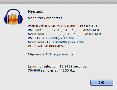

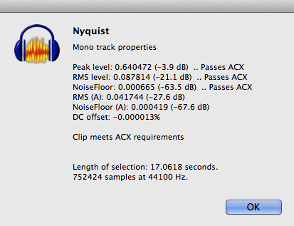

ACX does have a couple of videos. They start with how to record right after you install your sound proof booth. That’s where this is taken from.
They know bare floors just kills most people, so they start just after that. That’s how I do it. Soundproof third bedroom. No bare floors.
If you record just right, you can present a chapter, cut off the ends, make fluff corrections, reset the volume (capture volume and ACX volume are different), Export a WAV backup and the MP3 ACX submission and go make tea. There is no list of corrections, filters, effects and other production tricks.
