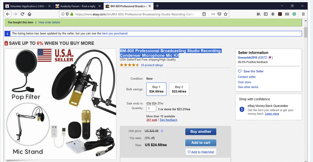

A word about that. Be leery of insanely cheap microphones that use the words “Broadcast,” “Studio,” “Recording,” or “Professional” in the description.
Here’s one that uses all of them.
If you tote up the prices of all the included accessories, they work out to the package price…which means the microphone is free.
And it’s appropriate. It’s a terrible microphone. Recordings made with it are non-recoverable. It’s a Hollywood Microphone. Great to look at but doesn’t work. That gold color looks really good on camera.
There’s another fuzzy rule. Everybody with a pulse is trying to record for voice-over and audiobooks, so all the cheap microphone makers came out of the woodwork with affordable microphones. The Yeti isn’t the only one with strident SS sounds needing correcting to make them presentable.
