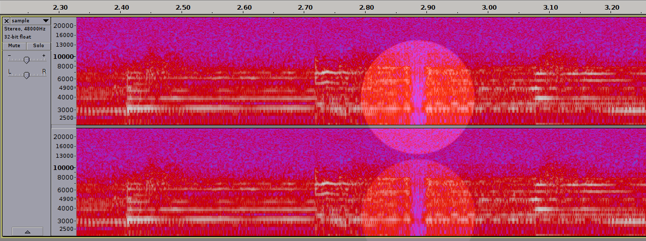

The main problem is there are dropouts: pieces are missing …
This can be due to programs fighting over control of input-devices, or interrupting in some other way …

Odds are there will be crackles where the drop-outs occur.
If the drop-outs are very brief all you will notice is the crackle where the join occurs.
Try giving Audacity “above normal” CPU-priority to lower the odds it will be interrupted by other processes.
If that does not work try Audacity’s free competitor … https://www.ocenaudio.com/

There is no hum on the audio you posted. If you can hear hum on it your playback device is adding it.
(If they are home-made recordings it’s possible there is mains-hum baked-in when they were created).
