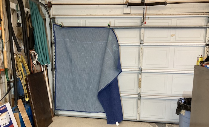

The one exception being the thin, metal garage door. That’s where the furniture moving pads race to the rescue.
I have a separate human door, so I can do whatever I want with the car door, but even so, It’s possible to hang blankets so the car door will still open.

That garage door will definitely need covering like you are doing.
It just struck me, wonder if that garage door can double up as a plate reverb?
Although not free hanging, it will have some form of rubber wheels running
on a rail, so it will provide some decoupling from the support mechanism.
It would be better if it was one solid piece of metal, but it may still work.
