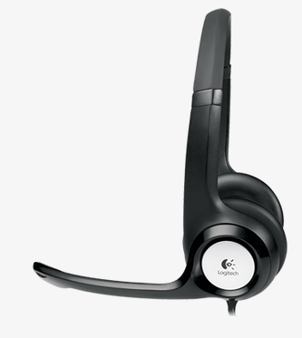

I don’t understand why there is no stereo line in connection
Look at your instructions. In general, that sound connection on the left is for a headset. Stereo headphones connected to a mono microphone for chat, communications, conferencing and Skype.
Nobody uses a stereo connection any more. Even Mac gave up. Some computers can switch that socket between different types of connection. Consult your instructions.
The On-Line promotion doesn’t even admit the laptop has sound at all. It goes on for several minutes how terrific the picture is. Good luck.
I can’t stress that enough. The quality of this hand-off determines the quality of the music. If you offended the sound gods, the music connection will be noisy, mono (not stereo) and easy overloaded and distorted. For some machines, that’s normal.
I took a moment to look up the “Dell Inspiron 14 7000”. The unit has the typical single 1/8" jack headset connection, almost certainly the TRRS Stereo out plus microphone in arrangement.
As Koz pointed out this is not suitable audio recording. You are going to need an external audio interface like the Behringer in Koz’s picture.
