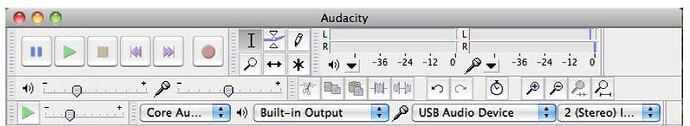

Apparently, when I installed V2.0.3, somewhere reading there was a download site for a manual in PDF format. It is certainly different than the 2.1.1 online manual. On page 6 of the manual, it clearly shows the 3 buttons I referred to, and as one goes down the manual, the colors change. I assumed these are the ones to use, and I was wrong. I will delete that manual and use the online version if I need assistance
That image is of Mac OS X and shows their red/yellow/green window buttons. You are on Windows.
Ah ha, it all comes clear :slight_smile:
The PDF manual that you have been looking at is not an official manual for Audacity. The screenshots have been made on a Mac computer and the “red, yellow, green icons” are the (standard Mac OS X) buttons for resizing the window. They are the Mac equivalent of the “minimize/maximize/restore/close” buttons in the top right corner of window in MS Windows.
