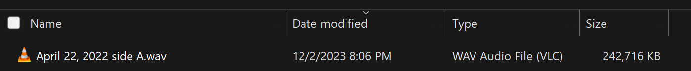

This is on-screen for about two seconds. A file is created using the name I gave it:
Open the file in VLC, the file is the correct amount of time (46:57) but no sound. Open the WAV file in Audacity, it has none of the project sound, just some light buzzing… none of the people talking.

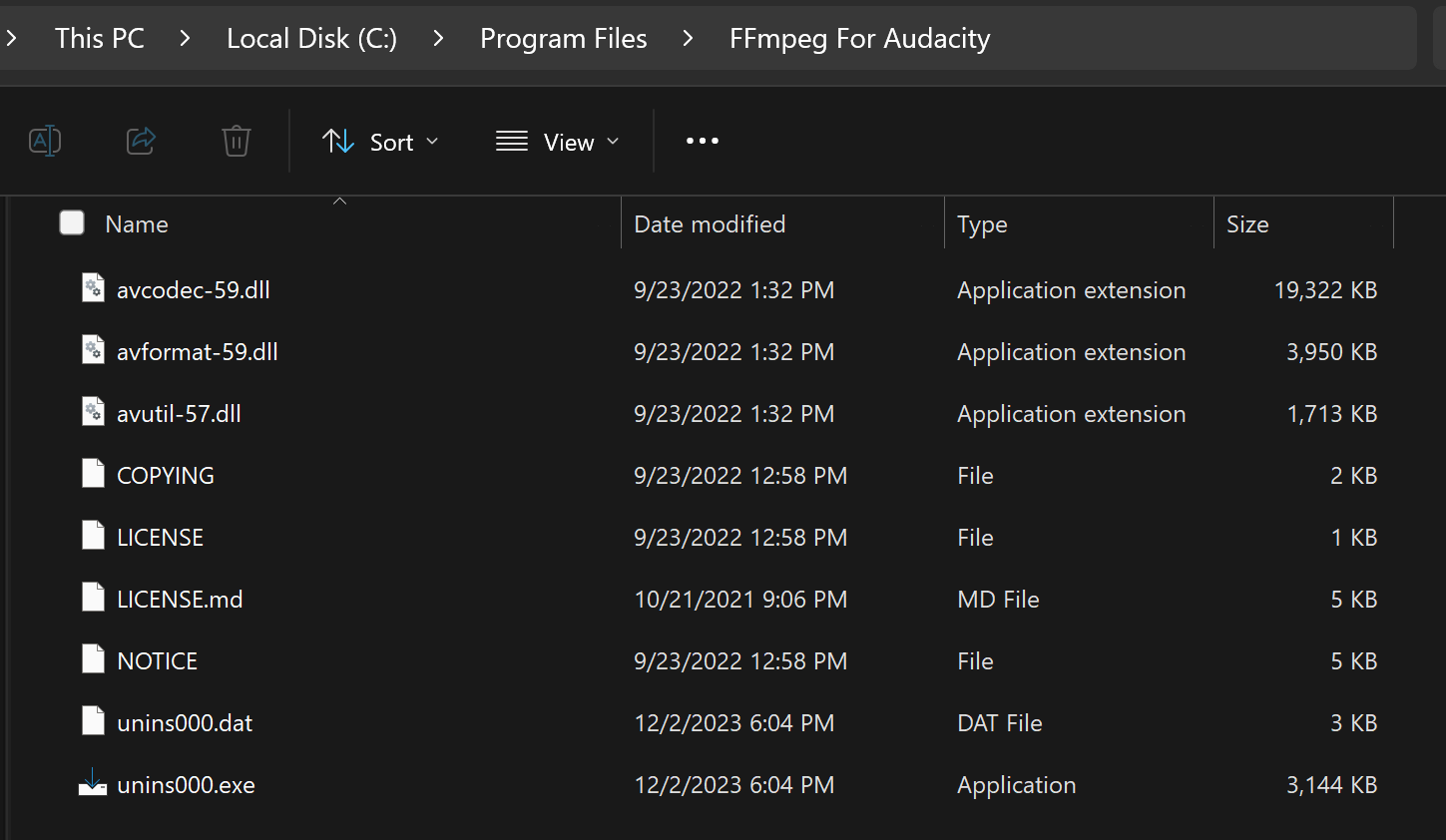

Here’s the FFMPEG directory:
To recap:
  • Have the latest version of Audacity (3.4.2, 64 bit) and of FFMPEG for Audacity 64-bit.
  • Saving a simple WAV file
  • Audacity is asking for “avformat-60.dll” but it doesn’t exist.
