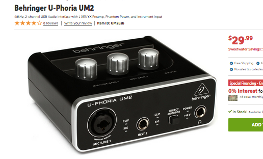

I have a nice, simple Behringer UM2 microphone and USB adapter. It seems to work perfectly every time I need it. It supplies 48 volt phantom power to microphones that need it.
I certified it for “perfect” overdubbing in Audacity. It has zero latency monitoring and will let you listen to yourself while you perform each part to a multi-part song. You will not be able to do that with the Sabrent system.
They make a fancier UMC22 and there is also a Focusrite Scarlett Solo. All do the same job at increasing cost.
