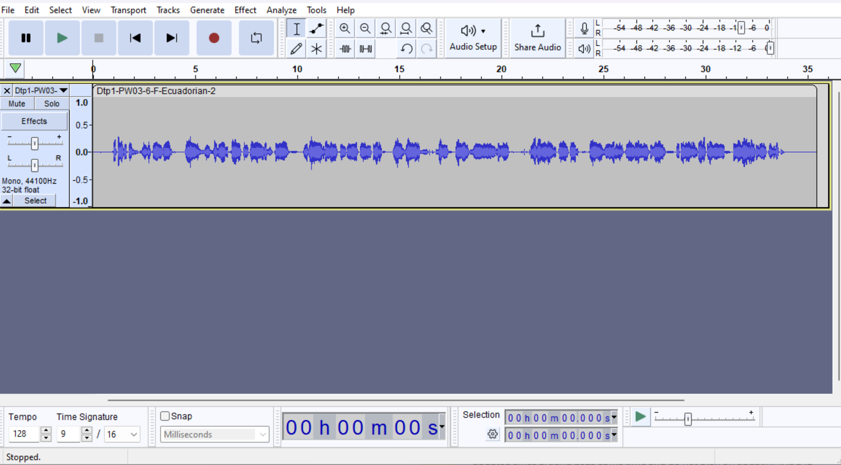

Hi! I need help please, I need to change the sampling rate and I cannot. It is not showing the Project Rate, nor the Audio set ups.

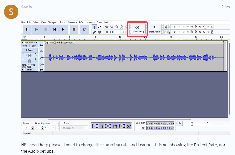

It’s right there! Drew a box around it for you ![]()
To change the sample rate, go to Audio Setup → Audio Settings… and then change the Project Sample Rate
And it shows the Project Actual Sample Rate on the very bottom bar of the screen at the Right Hand Corner.
