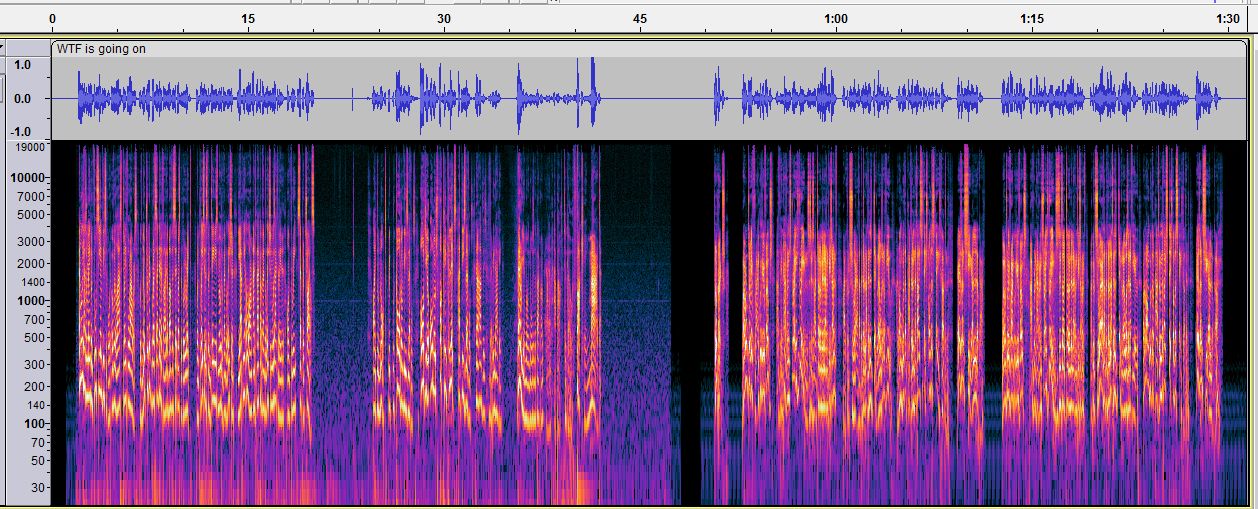

For some reason, out of nowhere, on this very night my noise floor just lept with a with a very specific hiss just going wild. This is unique because my noise removal software that I feed a V E R Y specific clip of noise barely does anything to lessen it.
I have not performed any updates, not performed any change to software, swear to god I did not even turn the bloody thing off from the last time I used it. I unplugged the charger, restarted my bloody audio interface. Nothing fixes it.

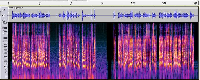

I have this. The second piece was lightly denoised and recorded 2-3 days ago, with everything being the same. I mentally exhausted and this is the last thing I wanted to happen to me today. Alas. You have any ideas friends? Thank you
I can hear a low level hiss that is around -60dB RMS. Is that the noise that you are referring to, or something else?
My audacity showed me going above 57 a bit more. but you can definitely hear a difference between the two recordings, right? I am not completely off my rails, right?
The second recording looks like a noise-gate has been applied …
Noise-gate “audio enhancement” can occur before the sound gets to Audacity.

I am not using noise get at all. That is all basically a result of me manually editing the recording (bloody hell that does look like noise gate)
I am using a quietened section that I put between the…whatchamajig…the like proper recorded audio, I am sorry, audio terminology and I are not close friends. XD. Mostly when you know, the lads outside get a little too rowdy, the last thing I want is to have some random background clatter contaminating my recordings, or 10or so seconds of nothing being between each take.
Hmmm
I used audacity’s built in noise reduction tool
reducing the noise with minus 5 DB
