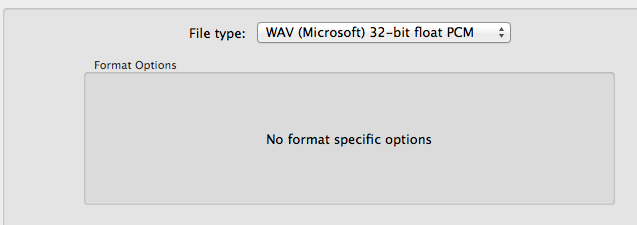

I am very interested in recording high sample rate sound. Through audacity, I get the option to raise the sample rate to 384000 samples per second. however, when I go into my mac microphone options, the highest option that I see for sample rate is 96kHz. I am wondering how audacity gets a higher sample rate. I would guess that the internal analog to digital converter has some sort of limit for the sample rate. Also, audacity has muliple output settings for sample resolution up to 32bit float. Is it possible to output the absolute raw data that audacity captured so I can parse it on my own?

Missed one. You can output your show at 32-floating WAV, but you should be able to point to someone who can open and play it. Otherwise you’ll have a unicorn pet on your hands. Nice to look at, but nobody can play it.
Also you can go into the Audacity setups and disable dither. 32-float doesn’t need it.

The bit depth is up-scaled to 32-bit floating point by Audacity. Floating point is better for DSP (digital signal processing). Virtually all ADCs & DACs are 16 or 24 bit integer (fixed-point).
As above, you can’t control the sample rate unless you go with ASIO hardware and an ASIO application.* You can convert losslessly between 16 or 24-bit and 32-bit floating point, so bit depth conversion usually isn’t an issue. Virtually all audio editors/DAWs use floating point “internally”.
