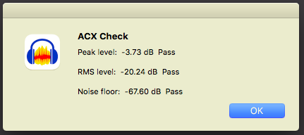

On my machine, Analyze > Measure RMS and ACX-Check give the same numbers. Or close enough.

Yes, the Analyze>Measure RMS and ACX- Check are very close.

It guarantees ACX RMS and Peak. If you recorded in a quiet, echo-free room, you may be done. It is a cousin to ACX-Check. ACX-Check inspects RMS, Peak, and Noise. Yes, ACX has on-line tools to do that, but they don’t check noise.

It easily passes all three ACX submission standards — and sounds exactly like me.
