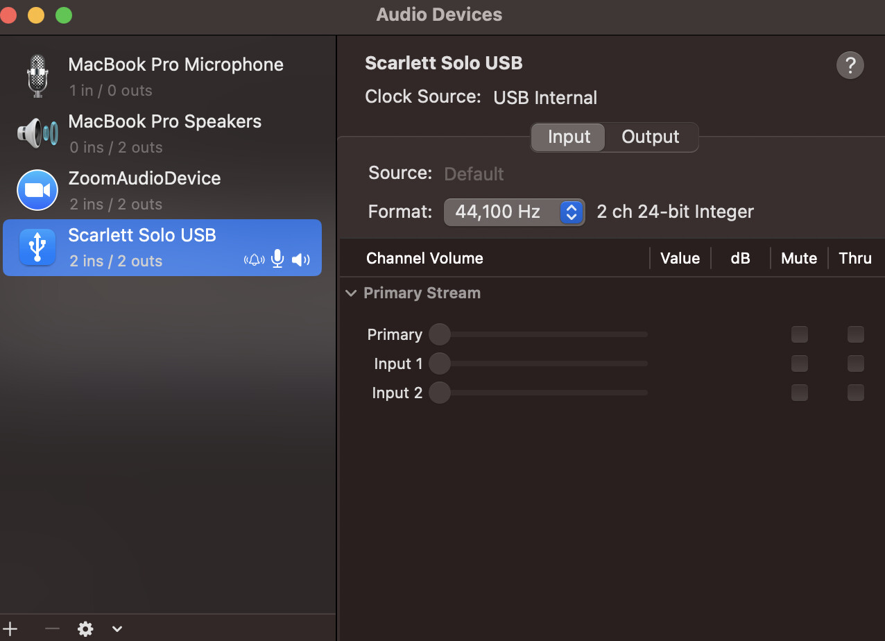

I’m on a 2019 MacBook Pro, and I can’t figure out why audacity will only record the left channel. I have set Audacity to record in stereo in the device tool bar, I’m using a Scarlet Solo which supports 2 channels. The channels themselves say they are stereo, but every time I record, it’s only the left channel. I have no idea what is wrong, please if anyone can offer assistance that’d be greatly appreciated.
SS below:
(the other audio file in the SS in an old recording, new recordings are only registering left channel)
Additional SS’s if helpful:
Maybe a dumb question but do you have something plugged into both Scarlett inputs? What happens when you swap the inputs?
Yes it does. The microphone on the Left and the Guitar on the right.

I appreciate y’all taking the time to respond & for the insight. Turns out the issue was a result of my own confusion. I use a different program to mix, which there, the audio file is converted to stereo. It ended up being a minor difference between PC/Mac, which threw me off. Sorry for the confusion, but thank y’all again!
