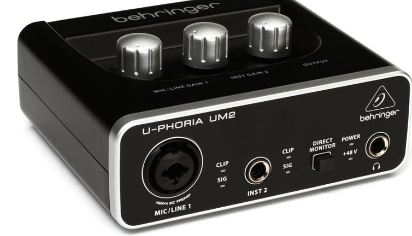

What is it? I use a Behringer UM2.
Røde has a very nice one, the AI-1. (That’s an “i”. Audio Interface)
Scratchy sound can be caused by simply using the microphone system wrong. See the two lights on the front of my UM2? SIG and CLIP? The SIG lights comes on when I use the microphone and system in its normal volume range. The CLIP light comes on when the sound is too high. Some interfaces use one light that changes colors.

Your interface has an actual sound level meter (flashing lights).
Play as loud as you can and adjust GAIN INPUT-1 until you only get green lights. Maybe an occasional yellow.
You should never, ever get that red CLIP light. That means the sound got so loud that it didn’t fit in the interface and has damage.
I bet the fuzz goes away when you do that.
