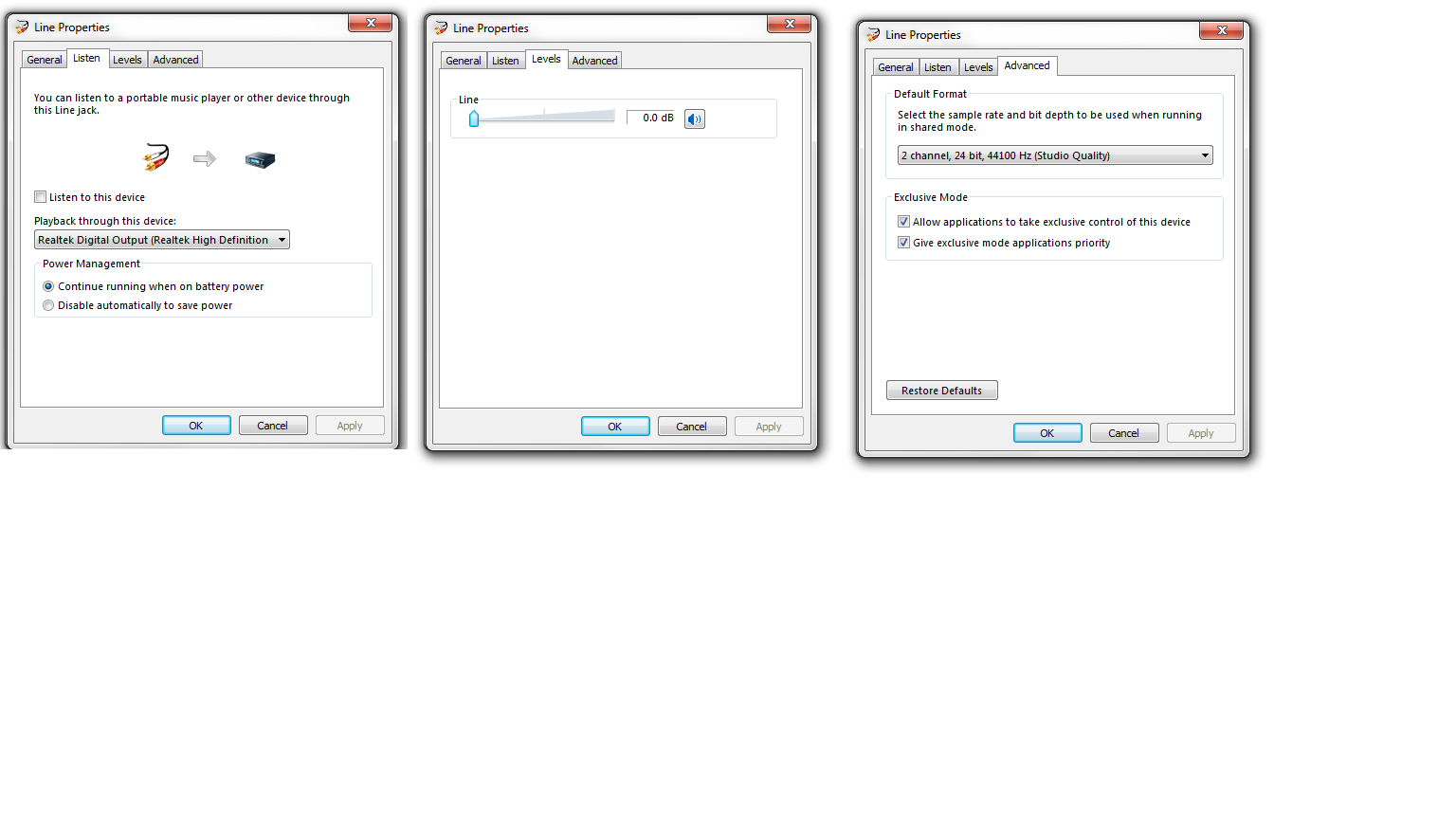

Here are some screen shots of my sound settings. They match the setup instructions HRT sent me. See anything? Want to see something else?
I’ve gone down the RealTek control path and can’t seem to find a volume control panel. I can find the Dell Audio control panel and regular volume controls accessable through the speaker icon. It appears there are only RealTek drivers loaded. No simular questions or answers to my problems have been found in the Microsoft Community forums. I’m still googling it…

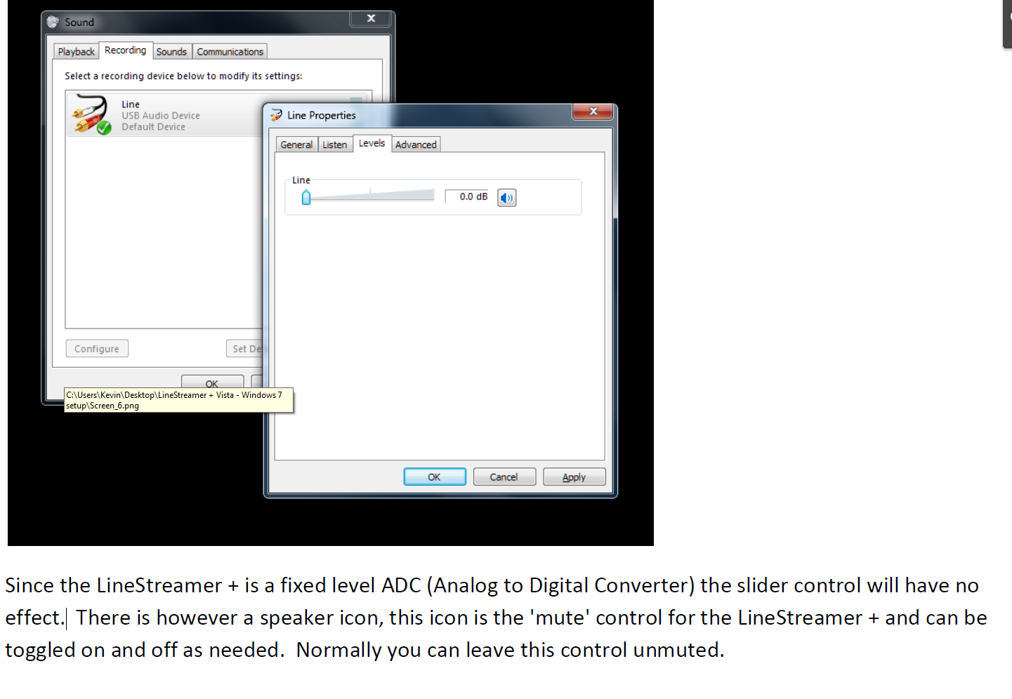

The “Levels” slider is set to 0.0 (silence = no sound).
According to HRT that is correct because it is an unajustable line level signal. The slider does not move and the db window is not editable. That was the same setting as used on the Win 7 32 bit PC where Audacity recorded everything just fine.
And, I do not have this muted. When I do toggle the muting on and off I can see the Mute indicator also turn on and off on the HRT device.
There is some setting or some conflict I’m just missing…that’s what’s frustrating. :blush:

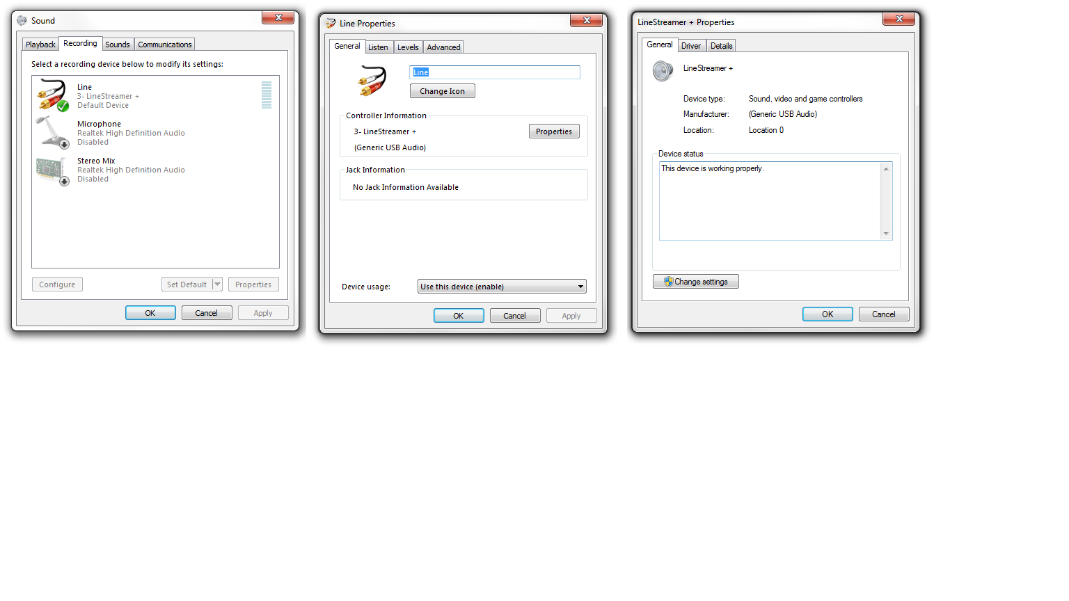

Why does the image in your last post show “Line In USB Audio Device”, whereas the image in this post shows “Line 3 Line Streamer +”
That was a screen shot of the instructions HRT sent me. The original image was the screen shot from my PC. Why the difference in names…I don’t know…maybe a clue?
It looks like they are using different drivers to you.
Did you receive an installation disk with the device or it using the default Windows drivers?
No installation disk. I have done an updated driver search and Windows says I have the most up to date drivers.
When I go into the Controller Information->Properties the Details tab does show it’s Value as a USB Audio Device. It’s named Line Streamer + in the Device Manager. I can delete that driver out of the DM and plug the device back in and the newly reloaded driver is still named Line Streamer +.
