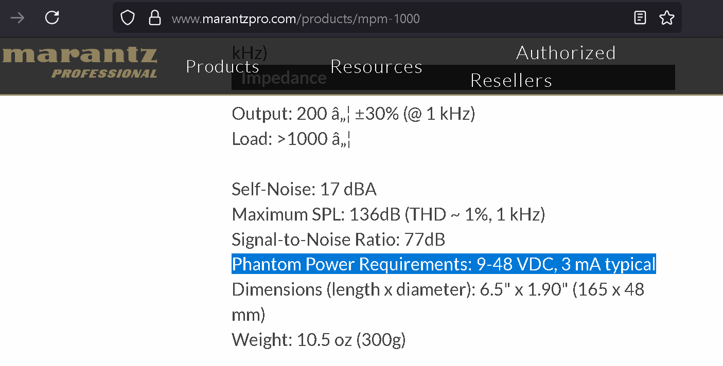

The standard is 48 volt, but 9 volt will do …
If the mic cable is very long (>100m) more volts are better.
