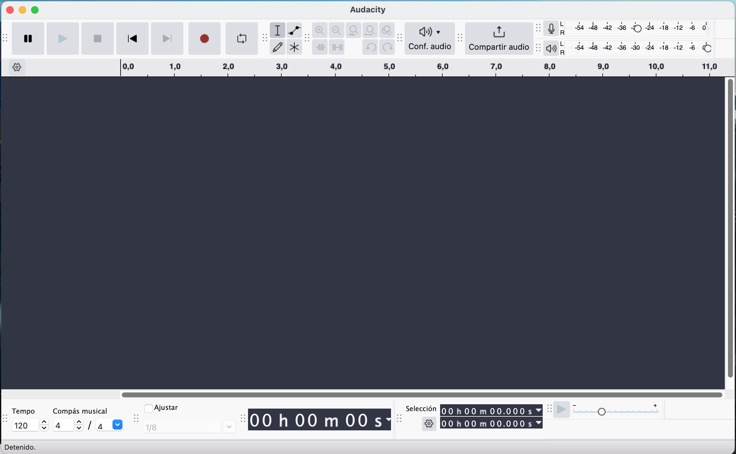

Hi,
When I open Audacity 3.7, the attached screen appears. I don’t understand why.
What were you expecting?
What you see there is Audacity 3.7 in the starting configuration. From here you can import tracks (via the menu at the top of the screen) or record tracks by pressing the red button.

You can configure your start screen by adding / removing / re-arranging items, at your desire. Probably, on your previous Windows machine, you (or someone else for you) did this in the very beginning.
