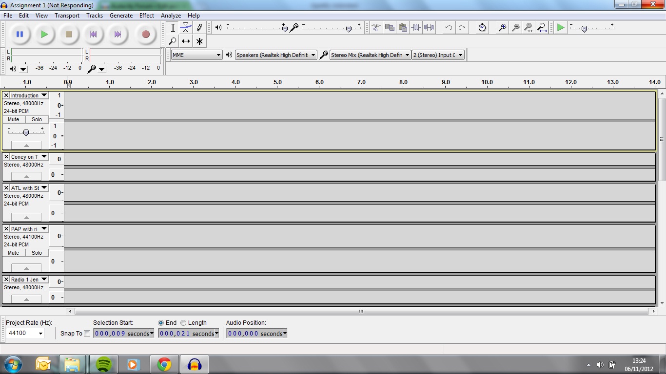

I tried the project on a Mac, but still the same thing seemed to be happening. I also downloaded and used the new .aup file, but still no luck. Thanks for trying though - that solution made sense in theory.
I’ve attached a screenshot of what it looks like, if that helps.
As Gale suggested, I suspect that the problem may have been due to a bug in Audacity 1.3 which has since been fixed.
If it’s not too difficult for you to redo the project from scratch then that may be the most expedient course of action.
