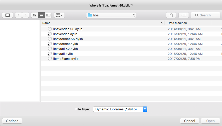

That’s the wrong file. You need to find “libavformat.55.dylib”.
The normal location for the FFmpeg shared libraries is /Library/Application Support/audacity/libs.

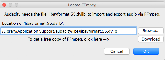

I don’t know why the Library preferences gives that message in the locate dialog. Mine doesn’t.
That said, you can click the “Browse” button and find the required file.
Before this will work, though, you need to download the FFmpeg installer and run it. Otherwise the “libav*” files will not be on your computer.
If you still get a message telling you to find “libmp3lame.dylib” when you’re trying to find the FFmpeg files, you may need to reset the Audacity preferences. This is done by going to ~/Library/Application Support/audacity and deleting the audacity.cfg file.
