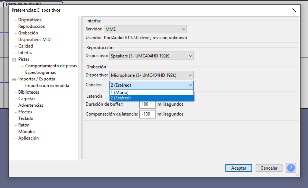

Hi! I have the same problem with Steinberg UR242 - Audacity (the latest version, but previous versions too) does not see inputs 3 and 4, only 1 and 2. All other daws (Ableton, Cubase) see them without any additional tweaking.
They are probably accessing the device via ASIO drivers.
Audacity cannot ship with ASIO support due to licensing issues, so you have the choice between MME, DirectSound, and WASAPI.
In Windows 10, “DirectSound” is emulated - it’s actually the same as MME but dressed up to look like DirectSound.
Currently you are using “MME” (as shown in the “host” setting of the Device Toolbar).
Try selecting WASAPI as the “host” and see if that works.
No, I tried all combinations, but it never worked. Usually, it was not a big issue for me, I used Audacity for fast recording of guitar ideas, it was convenient - no to load heavy DAWs for recording short ideas, but now I switched to stereo input 3/4, and cannot use Audacity for this purpose anymore :frowning:
I had the same issue, and I think its the DAW, which is limited to 2 channels, I tried in Rea.per and you have change input channels to the number you want
Check this out (not spam, but i cant upload imgs)
