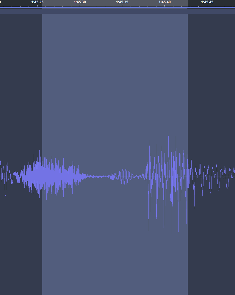

Audacity no longer plays back very short time selections of audio. To be more accurate, it does look like it’s playing, but no audio is output.
For example, in this image below, it will play back audio with output:

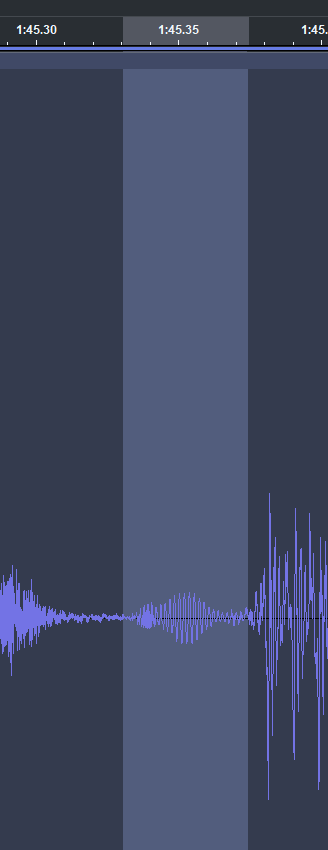

But if it is shortened to just the audio I am trying to edit (a vocal noise I want to remove from the track):
No audio is output. This makes it more difficult to edit small bits of audio because it’s harder to tell what waveform is matching up to the audio playback.
I know this issue has been present for at least several versions and I was hoping it would just get fixed with some updates, but so far no luck.
Is there a way to ensure that even very short time selections get played back?
