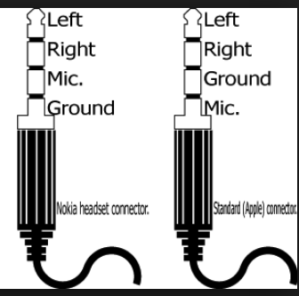

Are you sure it’s a microphone connection? If the connection is for a headset, then it’s expecting a really magic combination of metal rings in the plug and last check, they’re completely backwards from an analog computer microphone.
“Who wants a microphone? I want to use a headset and Skype to my sister in Schenectady.”

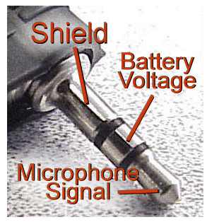

This is a common headset.
