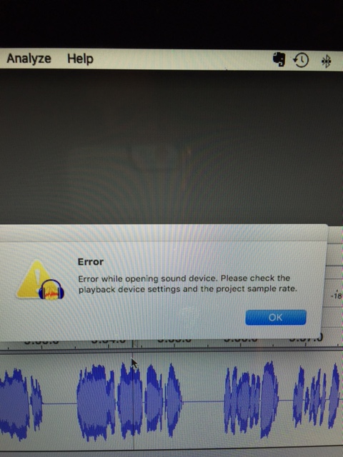

Well, in spite of installing a new hard drive, new USB cable for mic, and updating Audacity, I am still getting an error. See attached picture.
I am sure its due to El Cap. This didn’t exist before I updated OS.
  1. First, try disabling Bluetooth in system preferences. If that doesn’t help, go to the next step.
  2. Try disabling Airplay and Airdrop. This seems to work in some cases on El Capitan. Copy this command and paste it into the Terminal:
sudo ifconfig awdl0 down
Airplay/Airdrop will be back after you restart your Mac.
This problem started in Yosemite, BTW, but was later fixed with an update from Apple. It’s not fixed on EC, yet.
