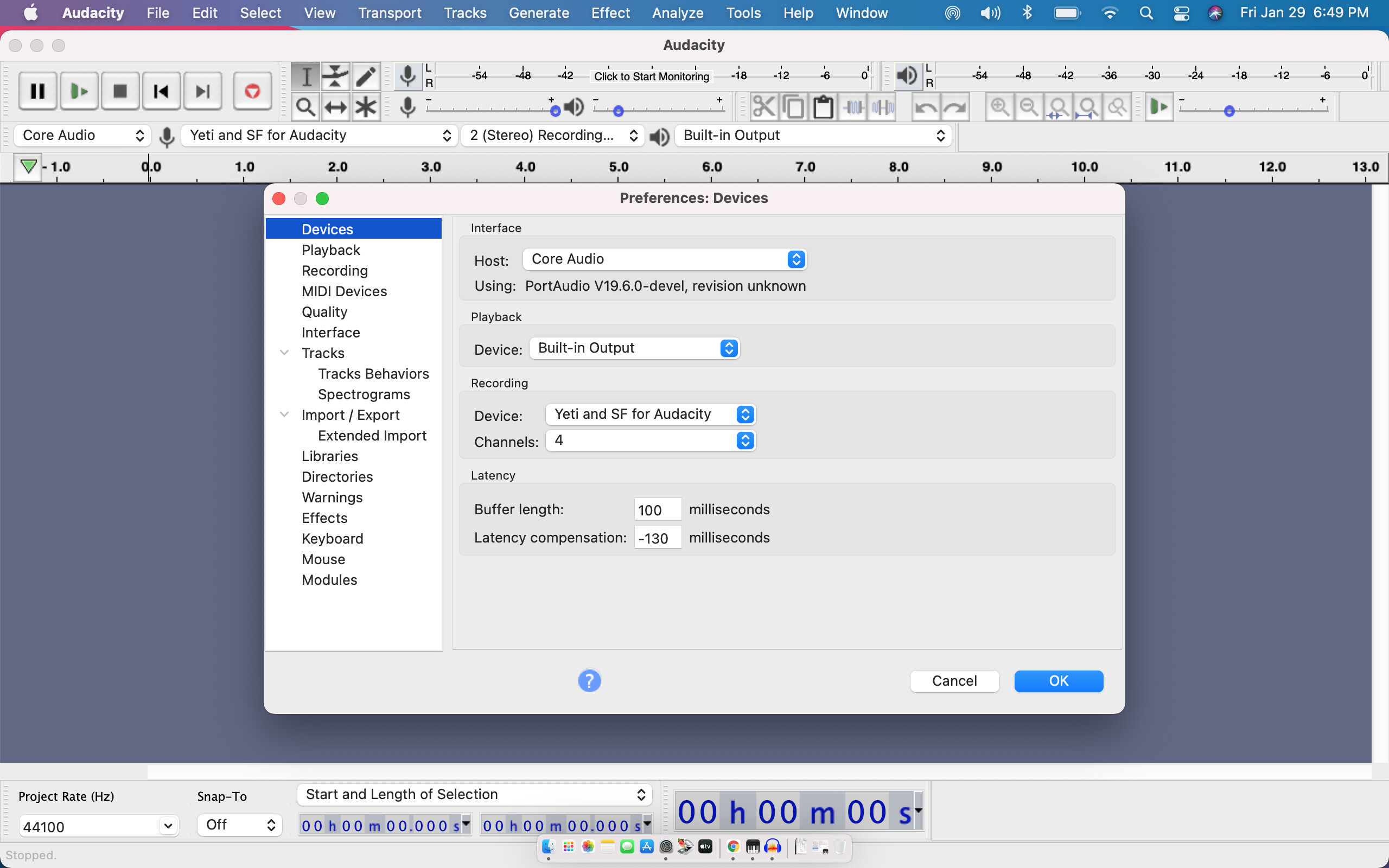

I created an Apple Midi Aggregate combining Yeti and Soundflower, and set up the Audacity Device correctly (input is aggregate, 4 channels) - Apple set up in System Preferences is correct for this set up also (re input and output)

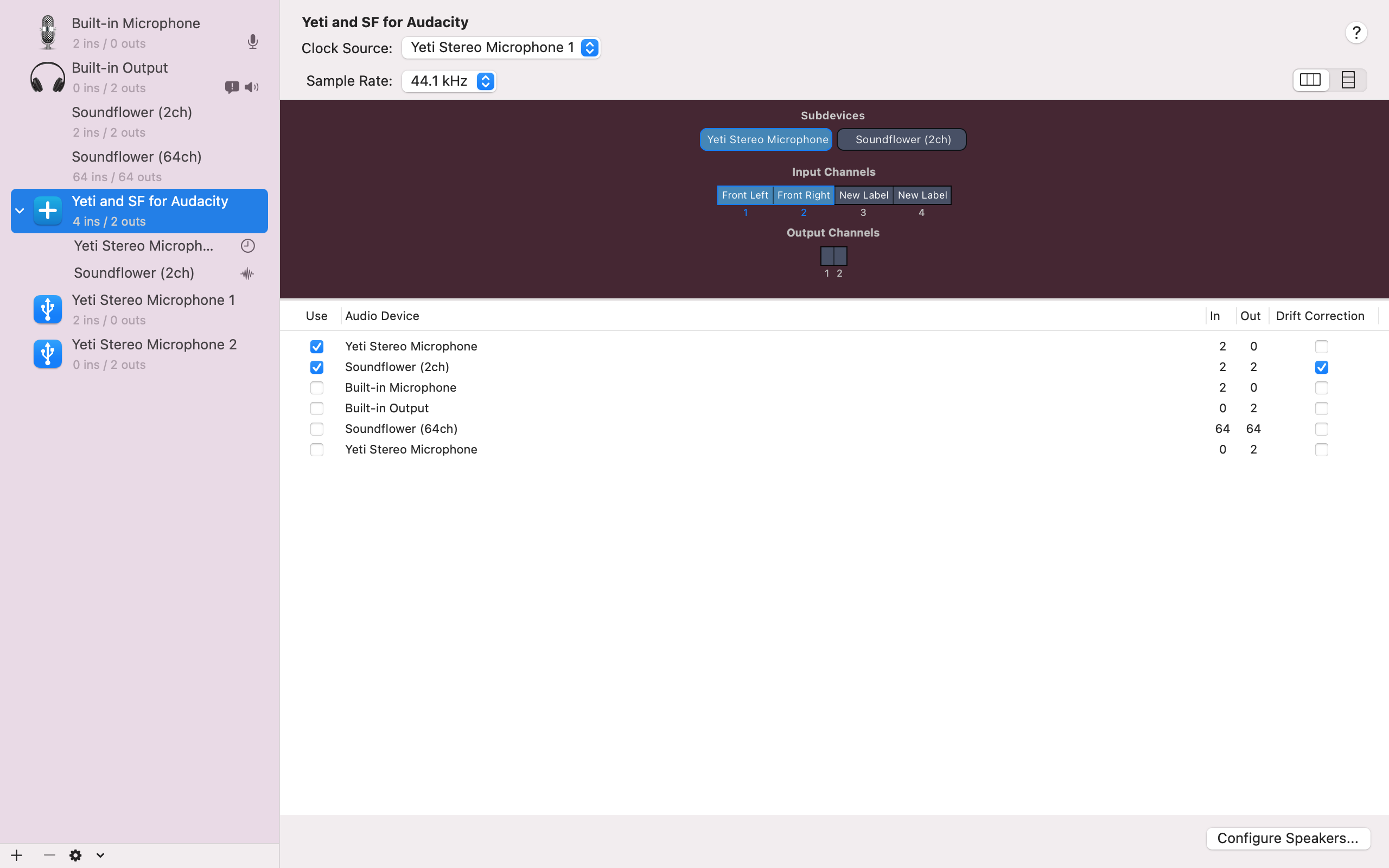

Have you checked the aggregate device in Audio MIDI Setup? I’m wondering if you disconnected the Yeti mic that the aggregate device would fail? Something changed between your first recording and subsequent ones.

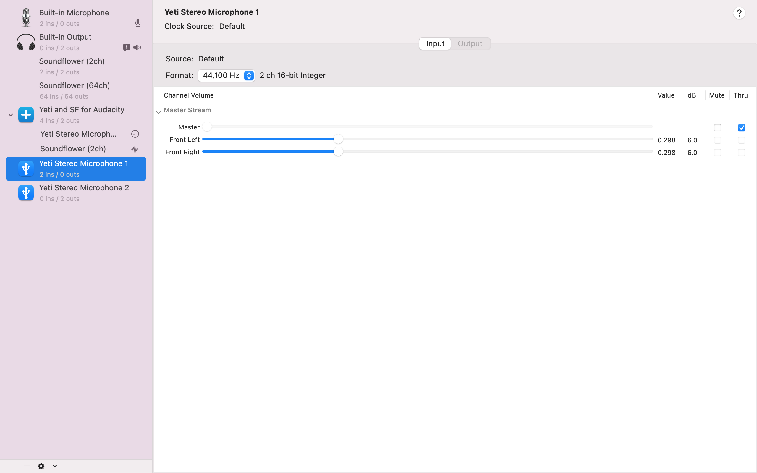

Good evening Bill, and thanks for your patience
I’ve attached the three relevant screen shots (I think they’re the relevant ones)
And indeed, on this evening’s test run all went well. Bit of a mystery that…
