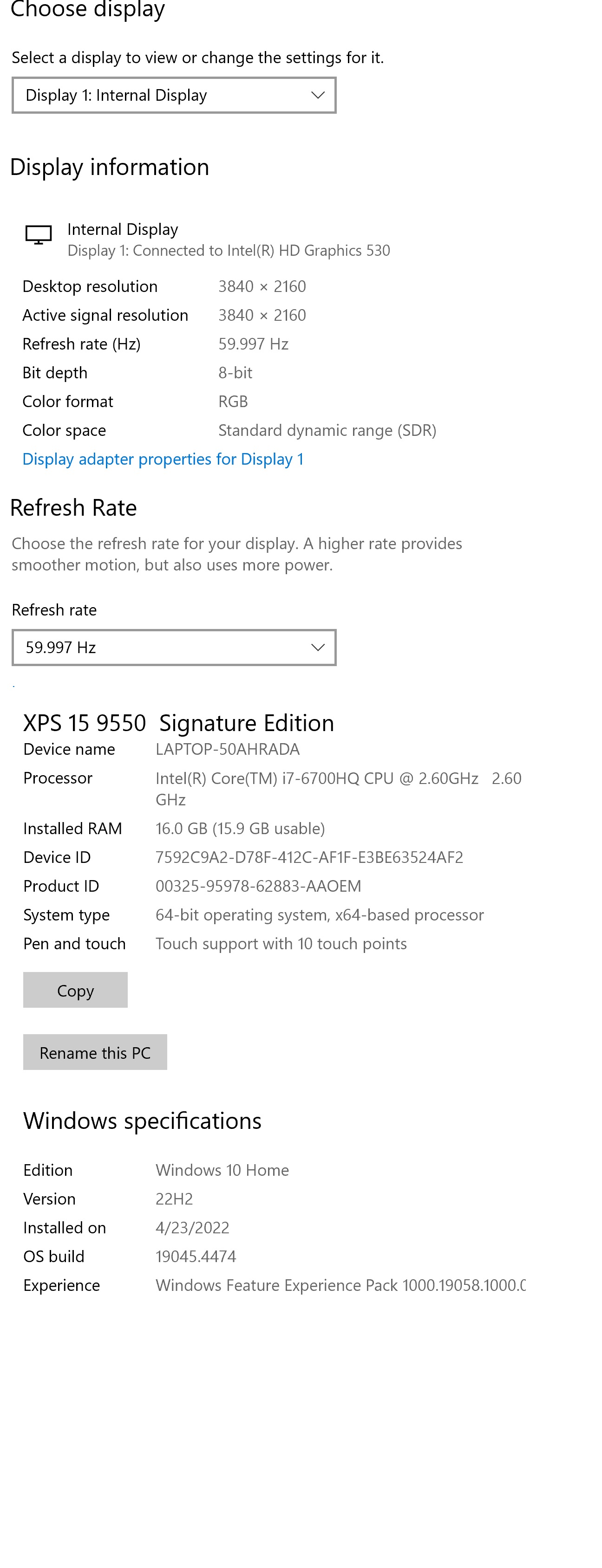

Hmm strange. What kind of CPU / GPU are you using?
I updated the intel HD graphics driver from the Dell website. I also re-installed audacity with the muse installer. (I had previously used the audacity installer)
Then I re-installed openvino. Now it’s working (even with the openCL.dll still in the audacity folder).
Not sure which of these fixed the problem but fyi.
