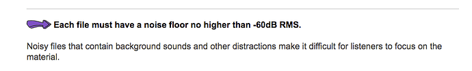

We should note that surgically inspecting Peaks and RMS (Loudness) isn’t as important as you think. Home Readers never pass Noise. The Noise specification is -60dB. In English, your room noise has to be a thousand times quieter than your voice. And that’s just squeaking past. Our recommendation is -65dB and quieter than that is even better.

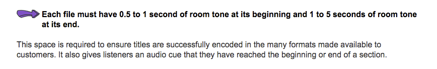

There is one production requirement that a surprising number of people fail. You don’t just open up and start reading. There is a required amount of room tone (gentle room silence) at the beginning and end of each chapter.
Trying to understand here… so if I fail the noise floor on ACX check but pass with No Issues Found on audiolab then can I submit a final MP3 or not?
Please be more specific. What were the actual results from ACX Check and AudioLab?
ACX Check is not the only way to check noise at home. The legacy method is by carefully selecting the area in your performance that you consider Room Tone or background noise. Another way to think about that is what you record when you stop talking and hold your breath for a second or two.
Then Analyze > Contrast > Foreground > Measure Selection. That’s the RMS (loudness) value of the noise in your selection.
We want to measure noise because it’s important to ACX for submission and they said so.
I haven’t sat through AudioLab testing in a while and they may have changed it, but even though they do not check noise, they do say you have to pass all the technical specifications listed, and noise is in that list.
