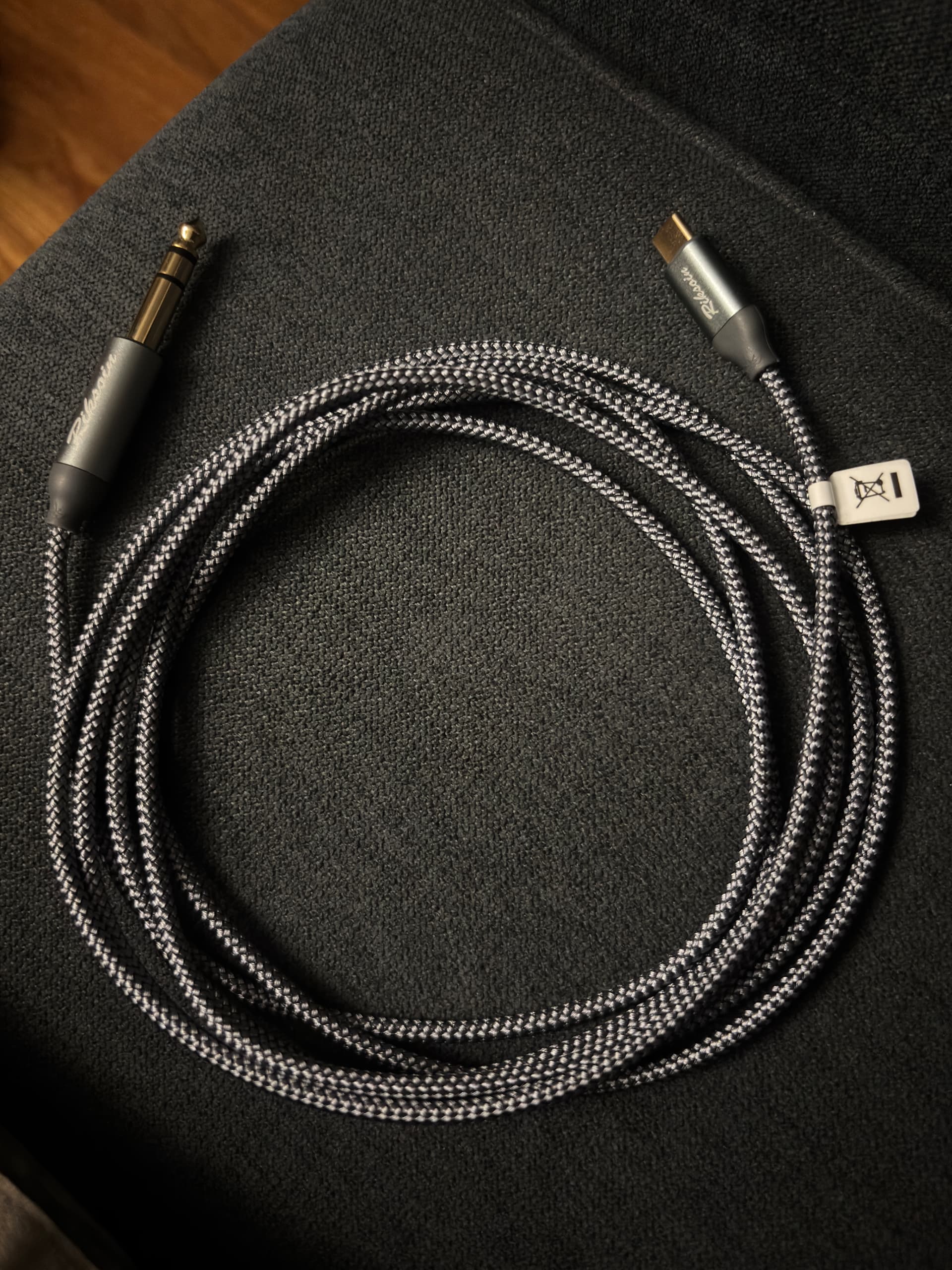

The cable I bought over Amazon it said P4 to USB-C.
Did it say it’s for recording? It could be a DAC for playback instead of an ADC for recording… Or something else…
Hum, it did not. Will need to check it
Problem solved!
It was indeed an issue with the cable. Thanks for the lead!

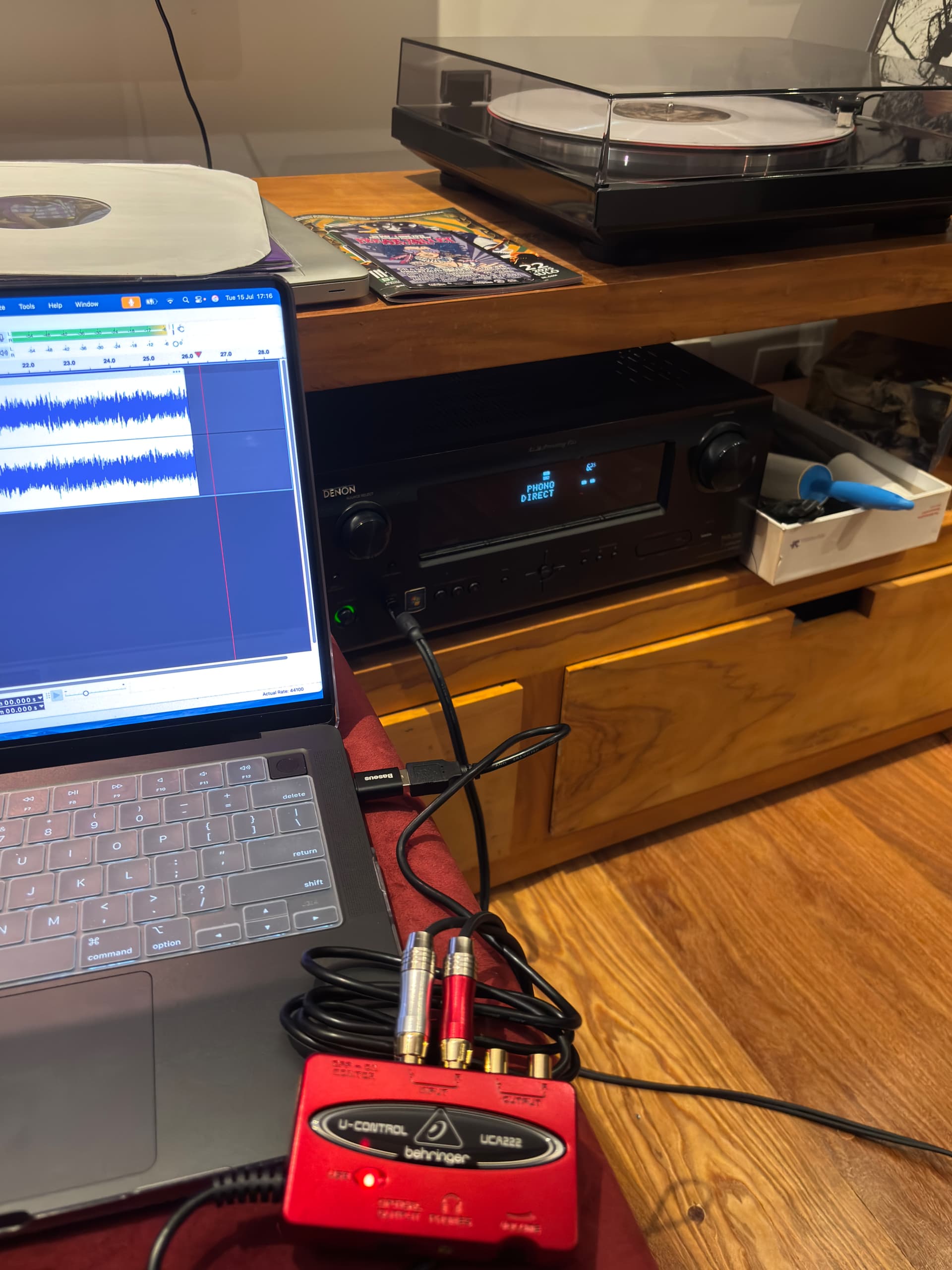

The cable I was using was a P10 6,5mm stereo (plugged in the receiver headphone port) one end and USB-C on the other end, connected to the Mac. The cable was a simple one bought over the internet that lacked conversion from analog to digital sound, so now made obvious, it wouldn’t work. I’ve replaced it with a Behringer UCA222
audio interface card:
INPUT = P10,6,5mm jack to RCA cable
OUTPUT = USB with USB-C adaptor
Sending a picture of the set up as a reference for others that may fall in the same issue.
Thanks again for your help!
