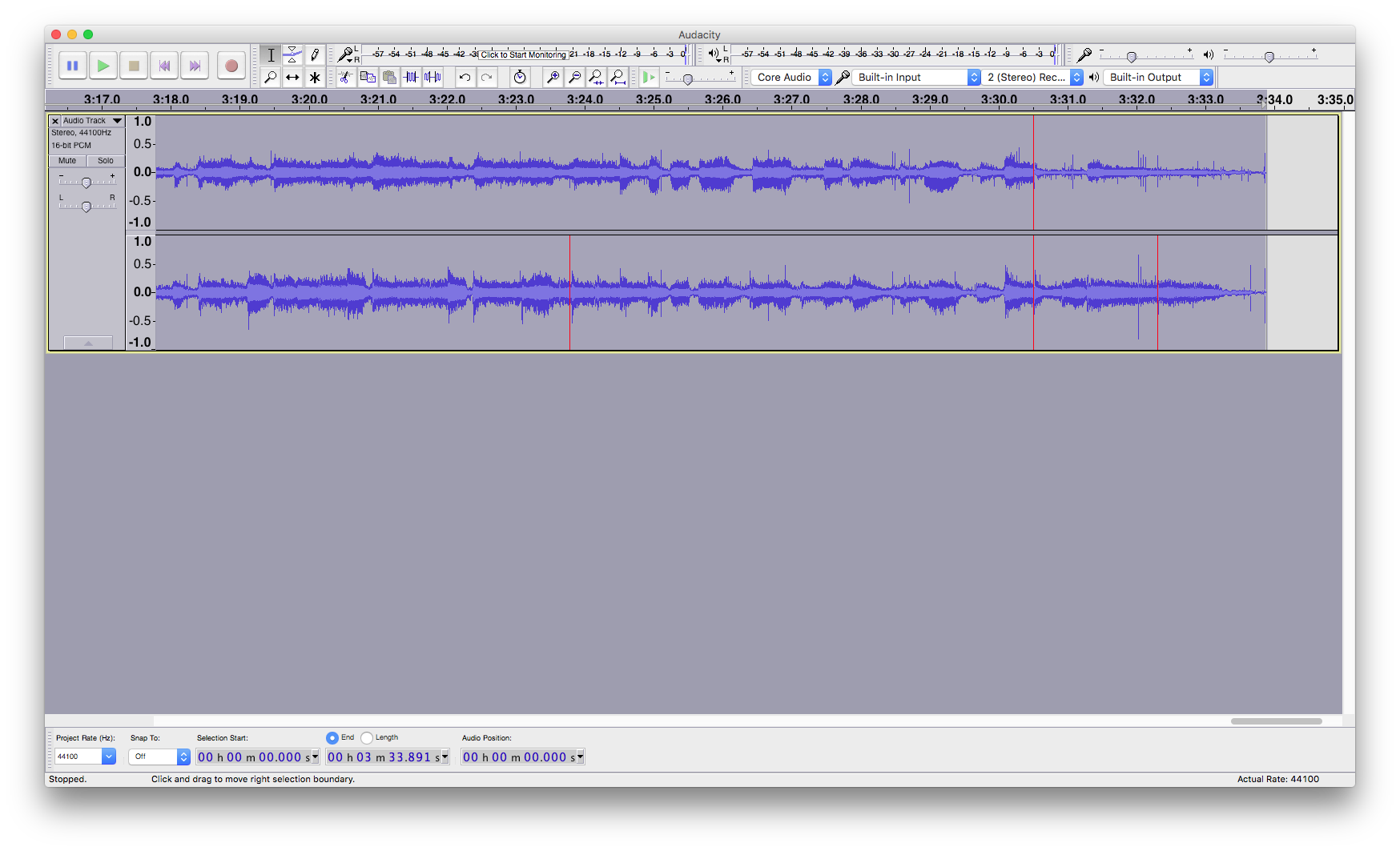

So, ran that test and did the following:
Amplification db: 2.2
New Peak Amplitude 2.1995
Allow clipping box selected
Settings Used in Amplification:
Clipping shown after increasing amplitude:
Picture recording live (clipping and no clipping bar showing):
http://www.designlabx.com/vinyl/audacity/nobar.png
After doing this, it showed parts of the track that clipped. However, I’m not sure what this really has to do with what I was doing before.

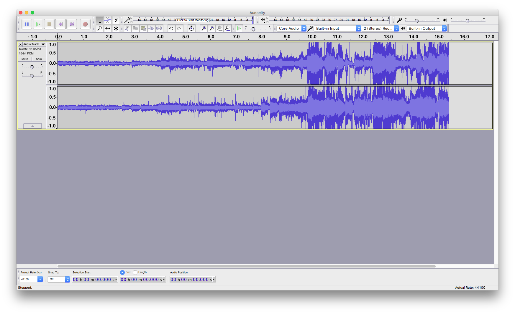

Previously, I was unable to get the clipping bar to show red while recording the track in 16bit mode. See the 3rd picture.
Let me know what you think.
The clipping indicator is certainly working, as demonstrated by the experiment.
Clipping can occur below +/- 1.0 in the Audacity track. Clipping will only show up in Audacity when sample values reach or exceed +/- 1.0, but clipping may occur before the signal reaches Audacity. If the A/D converted is working at 16-bit, which it probably is, then the absolute maximum signal level out from the A/D converter is +/- 1.0. If that signal is scaled down, even by a tiny amount, then the signal that Audacity receives will never reach the clipping threshold of +/- 1.0.
Also see http://manual.audacityteam.org/man/meter_toolbar.html#annotated - the Meter Toolbar clipping indicator only comes on for four or more consecutive clipped samples.
Honestly, I’m not sure I’m understanding what you are saying.
I will tell you this though. It is NOT working when recording in 16bit mode. I have had to continue recording at 24bit mode, as this allows the clipping bar, and ‘show clipping’ to work as it should.
So yeah, its not working. I’m not sure what your test was trying to prove, but, to me it seemed like a totally unrelated test.

However, the red lines do not show clipping either when the ‘default sample format’ is set to 16bit. Only 24 and 32.
I am using this for recording records, and while there is no clipping on my mixer, if the ‘booth level’ on my mixer is turned up too much, I want to be able to see clipping in audacity so that I can stop the recording, re-adjust, and re-record with no clipping. This does not work in 16bit mode. Only 24 and 32.
Video of clipping not working with 16 bit:
http://www.designlabx.com/vinyl/audacity/clipping_demo.mp4
Anyone check out the vid i posted above yet? Shows the issue quite clearly…
