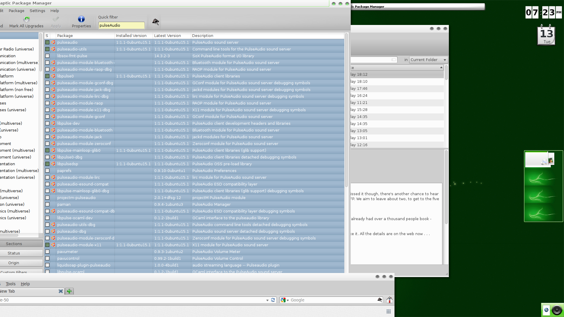

I am using Audacity 2.0 on Bodhi Linux which is based on Ubuntu 12.04, installed from repository (usb stick or cd)
Does Bodhi use PulseAudio by default?
See screenshot some lines missing at bottom

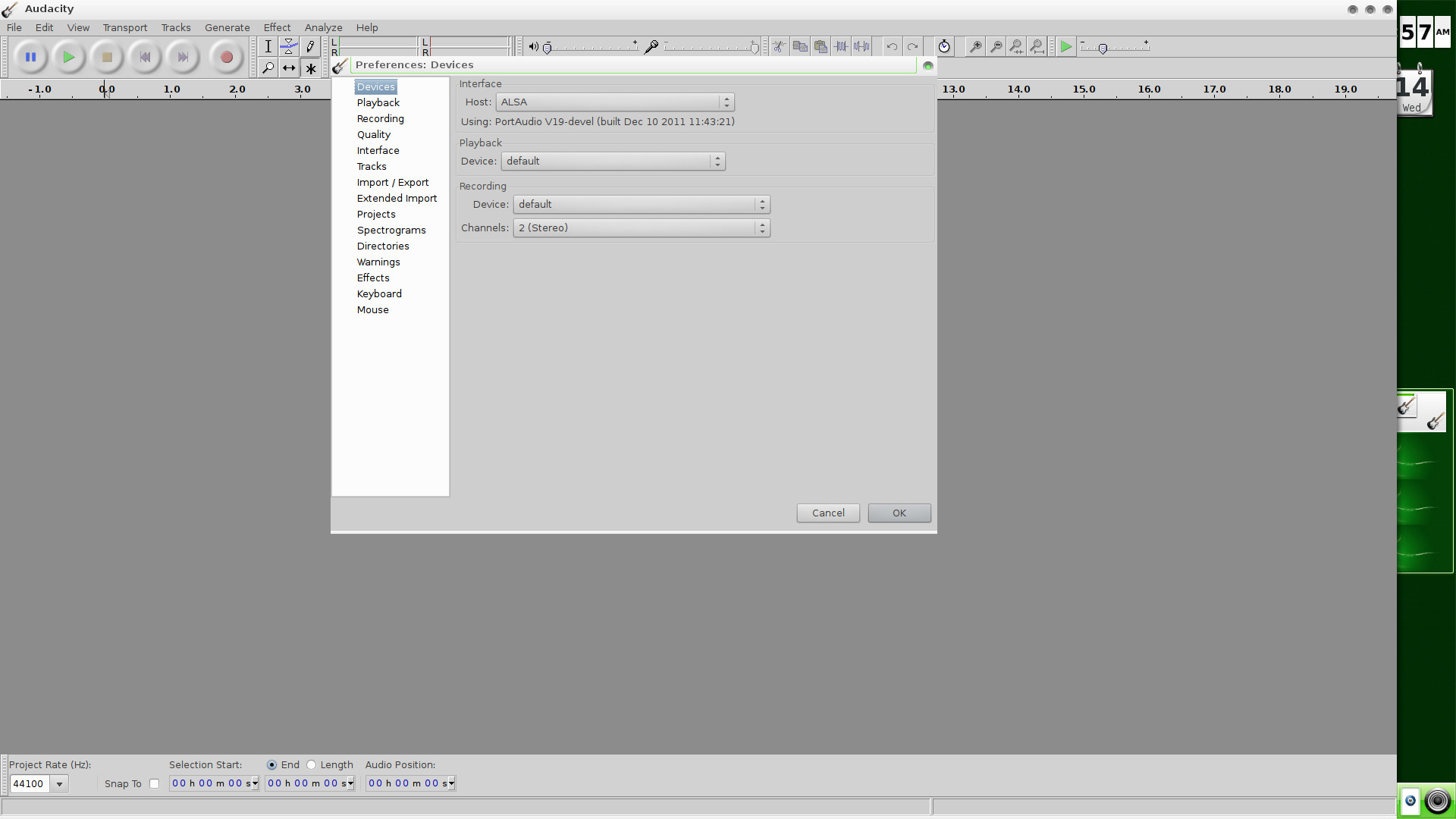

Ok Here is the first screenshot (audacity_screenshot) and I do not see “Audio Device Info” on that screen.
When I open “Devices” I get screenshot_2 … under playback and recording there are default settings but aldo “pulse” settings
