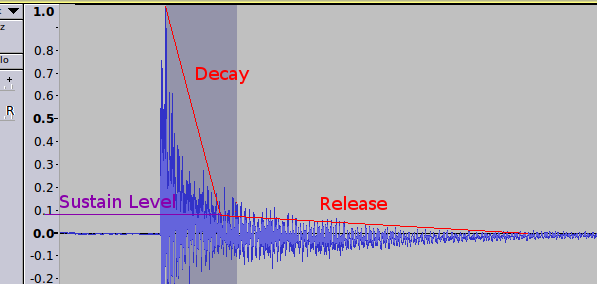

I don’t know of any analysis tools that will produce numerical outputs, but you can see on this image (a cowbell hit) that the attack is 86 samples duration. The sample rate of this recording is 44100 Hz, so the attack can be calculated as 86/44100 = 0.00195 seconds = 1.95 ms
(Click on image to expand)
Drum hits typically have a very sharp attack and a less sharp, roughly exponential decay. This does not work quite the same way as an ASDR envelope which is typically used by synthesizers. If you are looking to synthesize drum sounds, you will need to draw your own approximation as in this example:
The y axis is a linear scale +/- 1.0 (the default “waveform” view).
If you want the read-out in dB, click on the track name and select “Waveform dB”.
