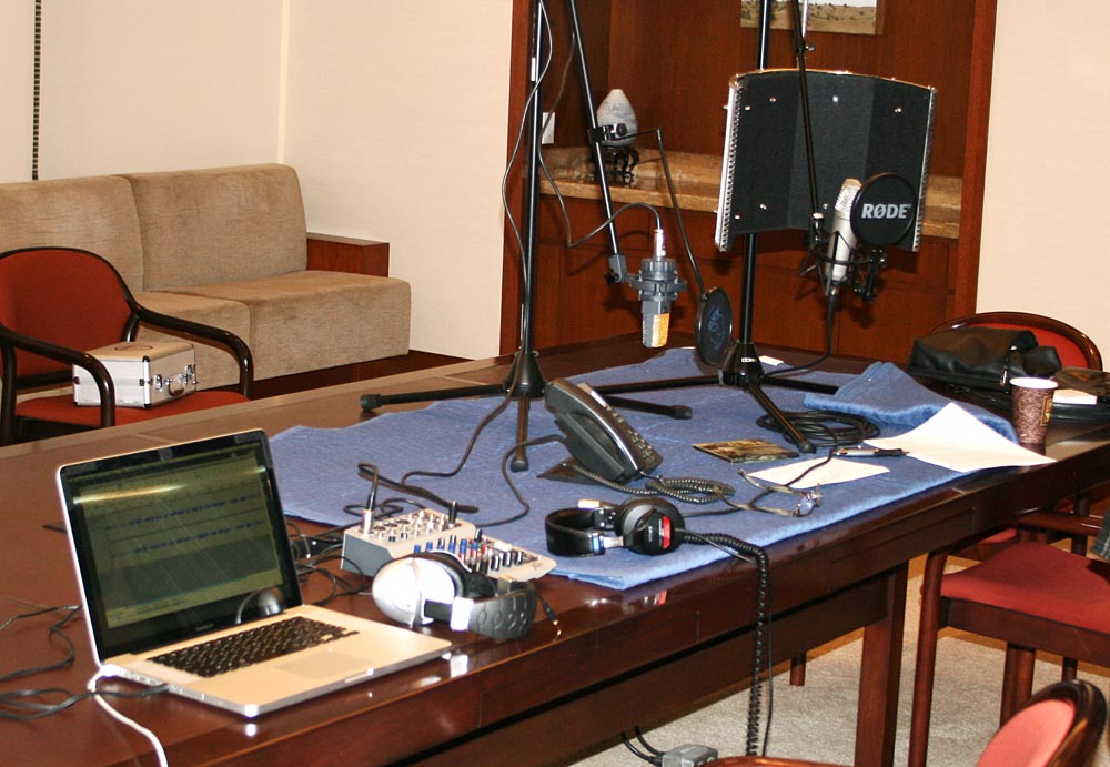

Do not use a desk mount at all. Voice reflections from the desk cause problems.
Note in this picture, the table is covered with two layers of moving blanket to suppress reflections/echoes, and the gold microphone on the left (the main one) is a good distance up – on a shock mount – with blast filter.
http://kozco.com/echoes/boxSoundShoot.jpg
The client and the announcer were both happy with the shoot. Yes, that’s Audacity on the computer on the left.
The client and the announcer were both happy with the shoot. Yes, that’s Audacity on the computer on the left."
If I don’t get a desk mount, what should I get? Doesn’t a shock mount need something to attach to, to be able to stay floating?
