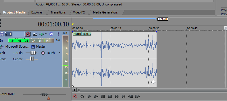

Now going to Sony Vegas which is the closest thing that resembles what you showed me of the red meters.
This is what my meters look like after recording for a few seconds.
http://i108.photobucket.com/albums/n11/NYCballa417/Untitled_zps5bdca1b8.png
I’m no expert on using a Microphone but I hope some of the stuff I went over was enough for you to know where my problem is or if there’s something else I can find out for you, just let me know!
