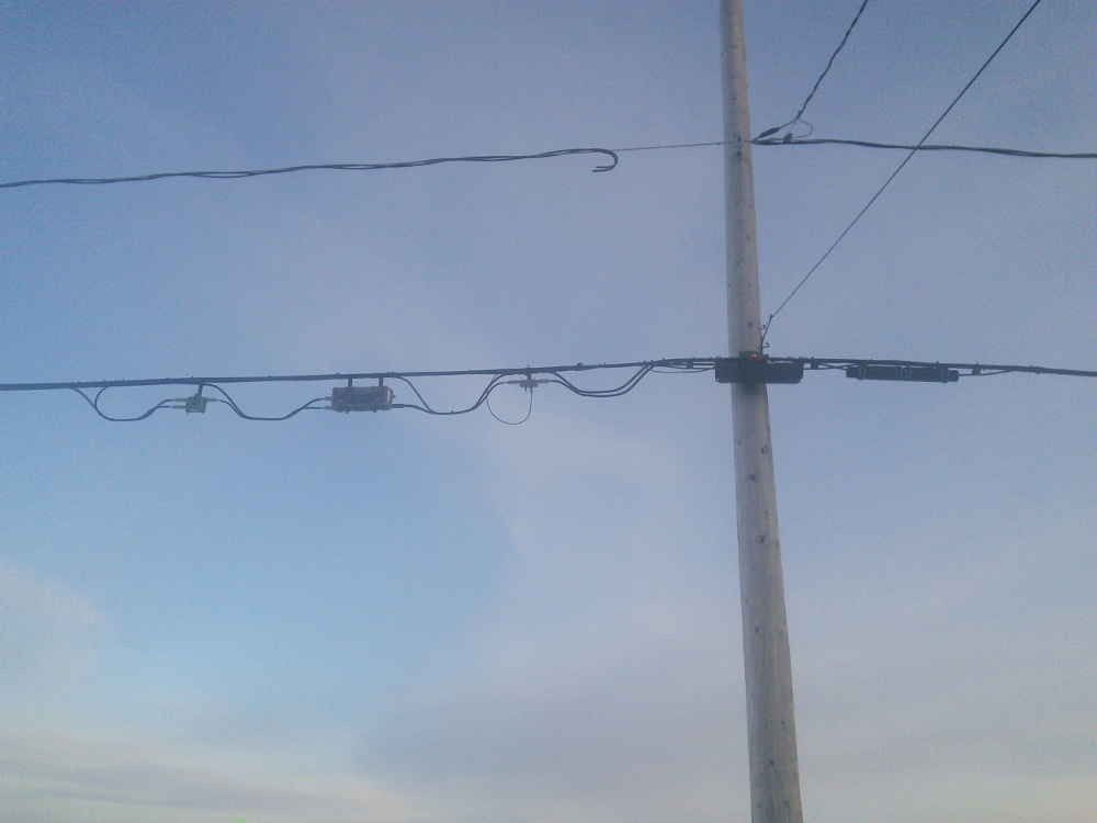

SOLVED, I think. I went outside with the Dual Pre and a Zoom H2n, and did some direction finding. Didn’t take long to narrow it down to these things (see attachment). When I stand under them, the meter pegs at 0db. So what are they, and what can I do about them?
That sure looks like the cable TV system. Good luck getting them to service it. Either Comcast or Time-Warner is the the most hated corporation in America. I think the other is second.
They’re not supposed to radiate. Companies are under strict rules as to how much radio trash they can produce. That’s the Part 15 rules you might find listed in the documents for your computer.
I wouldn’t be shocked if one of the screw-on connectors has weather damage and the protective shields are leaking.
Look like cable TV distribution amplifiers. You might be hearing a “keep alive” signal, that’s there to signal cable breaking.

Very surprisingly, the cable guy came, and he was very courteous, but could not find any problem with their equipment. So I walked down the street listening to the ART, and the noise varied in intensity but never disappeared. He suggested that a nearby farmer might have equipment sparking on the AC line, which would explain why the noise increases as I approach the electric line. I can’t imagine what kind of equipment would draw electricity every 5 seconds. I guess the next step would be to drive around while listening.
