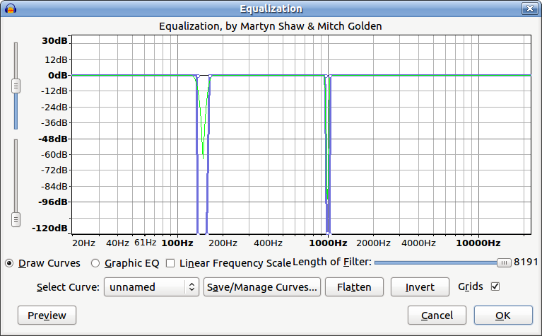

You can make a notch filter using the Equalization effect. You may need to check the results against the spectrum plot to get the notches in just the right place, but something like this will work: (see here for an explanation of the settings http://manual.audacityteam.org/man/Equalization )

The next easiest way that I can think of is to make a double notch filter using the Equalization effect.

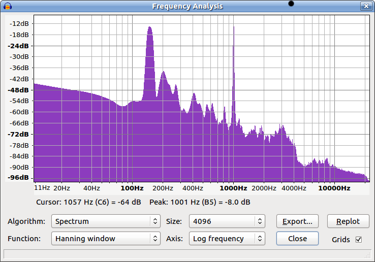

How did you get to that settings, I mean did you use Analyze → Plot Spectrum?

Yes and no, in order. Plot Spectrum will show blue waves that will go up and down with the different pitch tones in the sample. Drag-select a portion of the show with interference alone – as much as possible. Analyze that. We already told you where to look for the blue upward spikes in the waves. You can pull the analysis window large and larger to get greater and greater detail, plus you can increase the SIZE number to get even better accuracy.
Write those two numbers down (yes, I know you already know them) and apply them to the notch filter one at a time. Listen carefully before and after you do that and the tones should be gone.
Listening is a very serious part of this and in the sense that photography will tell you how to see, Audacity will tell you how to hear.
The mess to the right of the actual note, G1, is the overtones and harmonics that make a piano a piano. Those spikes are very different between a Steinway and a 7-Eleven or Tesco piano even though they’re playing the exact same note. That tall spike toward the left will be the same on both.
