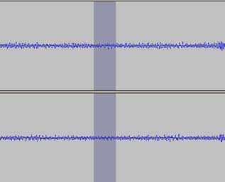

The “HUM” I’m complaining about is rather weak, but is still there. Here is the screenshot at the ‘profiling’ stage:
[/img]
Unless you have magnified the vertical scale, that still looks like quite a lot of hum, and complete removal may not be possible.
Make sure that you have a sample of hum that is COMPLETELY absent of any music (sample it before you put the stylus on the record). Try adjusting the noise reduction settings.
Are you using Audacity 1.2.6 or 1.3.4 - they have quite different noise removal effects - I usually prefer the one in Audacity 1.3.4, but occasionally (depending on the musical material and the kind of noise) find that the earlier one gives better results, so try both.
