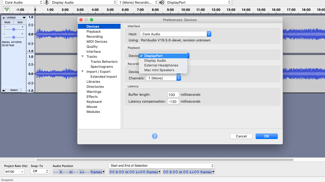

Screenshot of previous Audacity file
Recorded and saved in Audacity with Mac mini 2009.
Opened on mac mini 2018.
Audacity uses core audio for its mac software.
I am pretty sure the recording devices in the dropdown were not same as mini 2009
I suspect “Line In” was.
So if I have an USB audio connector
Should convert analog to digital USB
but will it show up in core audio as an option?
I suspect not.

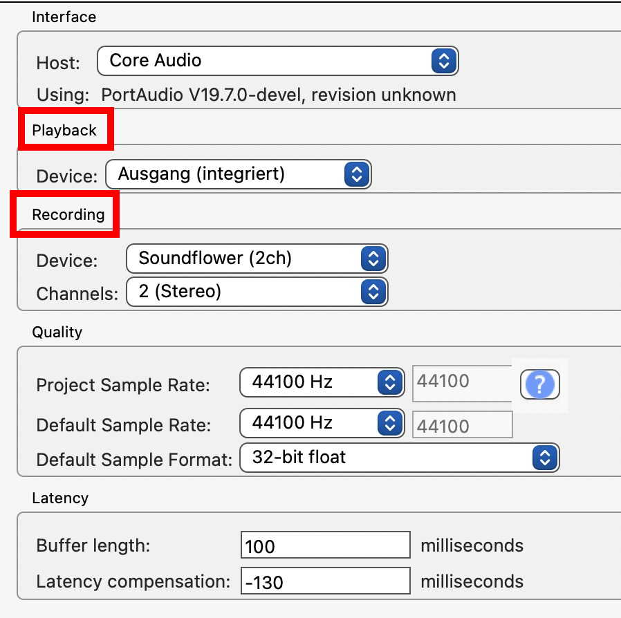

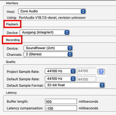

You’re looking at the wrong place.
You set the “Recording device” (and also the Playback device) a bit down in the settings, see the image below.

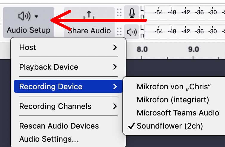

You can also set these outside of this settings dialog in the “Audio Setup” button.
The recording device needs to be connected before Audacity starts. Or you need to select “Rescan Audio Devices”, if they are connected after the start.
I see in your image that your recording would be mono (1 channel), not stereo. Are you sure you have a stereo-capable audio device?

The sound input will show up in the places I mentioned to you earlier (Audio setup button, or in the settings dialog below the “core Audio” line). Did you look at the images I posted, and did you (try to) understand them?
