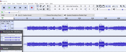

I think this is what you are looking for:
In this video, note:
  1. Right-click on time-line to Enable Quick-Play
  2. Right-click on time-line to Enable Dragging Selection
  3. Right-click on time-line to view updated context menu.
  4. Click drag in waveform to select audio from 0:30 to 1:30
  5. SHIFT-click at 1:25 in time-line to play selected audio beginning at 1:25-1:30, automatically looping back to 0:30 and continuing.
    [Note: if you watch Record Button carefully, you can see when SHIFT key is pressed]
  6. Note that quick-play end-points can be dragged.
