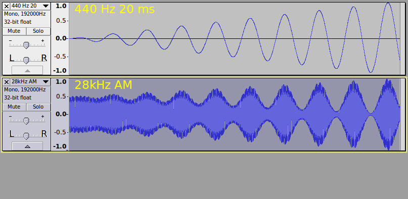

Ok, so the nyquist code should be:
(mult (mult 0.5 (sum 1 s)) (hzosc 28000 *table* 90))
for a 0.5 modulation index?
With a 0 dB (full scale) “message” envelope, the modulation will be 100%
By the way, in the current “version 4” syntax, that code could be written as:
(mult 0.5 (sum 1 *track*)(hzosc 28000))
