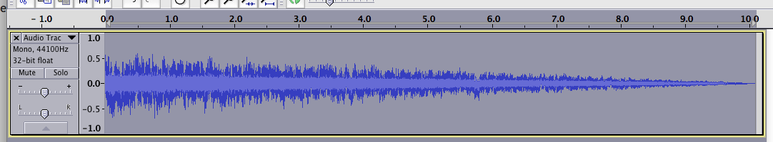

You could force the effect to reveal itself. Put a song on the timeline, select the whole thing by clicking just above MUTE. Effect > Fade Out. Play it. The song starts out normal volume and fades to dead silence. Somewhere in the song, the system will have to make a decision to “give up.” It will be interesting to hear what it does at that point (attach).
OK, thx. I will in a half hour as I was ‘otherwise engaged’ just now. Stay tuned;)
Done and done. It happened to be John Hiatt’s ‘Cry Love’. It ‘gave up’ right where I would have expected, where the green arrow points:
Did it stay one volume all the way down or did it slowly fade?
I would never have asked if I had any idea why the Amplify effect does not, in my case, amplify.
Well, there is one other possibility. People have posted with fake, impossible or contradictory questions just to see what we would do.
Koz, you ask: Did it stay one volume all the way down or did it slowly fade?
it slowly faded from full volume until there was just vinyl rumble.

I’m fascinated by not knowing what the goal is. If it is a service or tool trying to independently set volumes, what’s its goal? It’s not blindly trying to keep the overall volume constant. That would have destroyed the ramp test.
I guess we don’t know what happens if Amplify is applied so as to reduce the volume. Also, if you increased the volume of a test performance and exported it, does it import to a fresh Audacity at the new or old level?

“Amplify” is “to make the waveform bigger vertically” (increase the “amplitude”), and we can all see that it has done that. The “mystery” is, why does the amplified track not sound louder. As gale hinted, DFX looks to be a possible explanation DFX Audio Enhancer Download Free - 13.027 | TechSpot
