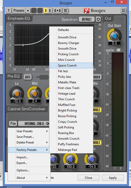

Thanks, guys. I loaded Boogex and it works fine. However I noticed that part of the plugin face is grayed out. The two input areas where the user can load cabinets and/or effects are grayed out and fixed at only one choice. Anyone familiar with the plugin and how to add different speakers and effects to Boogex?
Thanks again for your help.
Click on the Hamburger button on the bottom left corner of the Boogex GUI to see the factory presets …
Thanks, Trebor.
It’s interesting that even if I select a different cab or effect, the grayed out wording in the input boxes still do not change, despite the fact that a different item is loaded. Not a problem, they are probably just saving resources.
Thanks again!
The enable buttons remove the greyed-out state for me …

Unfortunately mine doesn’t have “Enable” buttons. Beats the heck out of me. When all else fails, it’s time to read the manual…
Mine is version 2.3.0 , VST (not VST3) …
Mine is v 3.1. Downloaded it yesterday.
