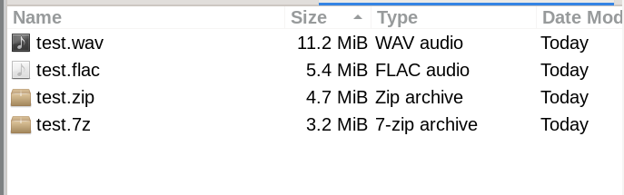

I’ve just tested a 32-bit WAV file. Here are the results.
(The FLAC is a 24-bit FLAC. A 32-bit FLAC file would be bigger):
Compress ratio depends on source file. Some music compress better, others got less effect.
This track have 6 channels. wav is 32 bit signed. flac is 24 bits.
7z have slow time to compress (and decompress!) comparing to zip.
