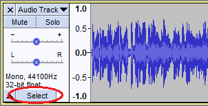

select the track you want to modify …
then any effects will only be applied to that track.
BTW Using the time-shift tool is easier than padding with silence …
It sounds like you have Sync-lock Tracks selected. If so, de-select it.
