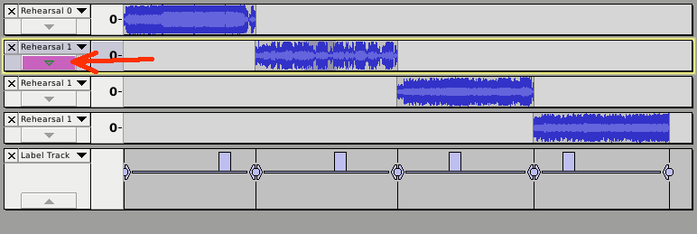

Gale, I still can’t get the tracks to align end to end but the reason I want it like that is because, when trying to add track labels to the first (top) track, the labels appear under the second (bottom) track. Is that correct?
While working with multiple tracks, you may find it easier to “collapse” the tracks to minimum height. (View menu > Collapse All Tracks Ctrl+Shift+C).
If you need to work on a specific track, restore it to its previous height by clicking on the button at the bottom of the panel on the left end of the track.
You can instead Zoom Out (COMMAND + 3), press F5 to switch to Time Shift Tool, then click in the second track and drag it righwards where you want it.
Press F1 to go back to Selection Tool when you are finished dragging.

You can also try enabling “Automatically fit tracks vertically zoomed” at Audacity > Preferences…, Tracks section. Assuming your Audacity window is full height, then with only two tracks and a label track, everything should always fit itself to the vertical screen height without contracting the track height too much.
