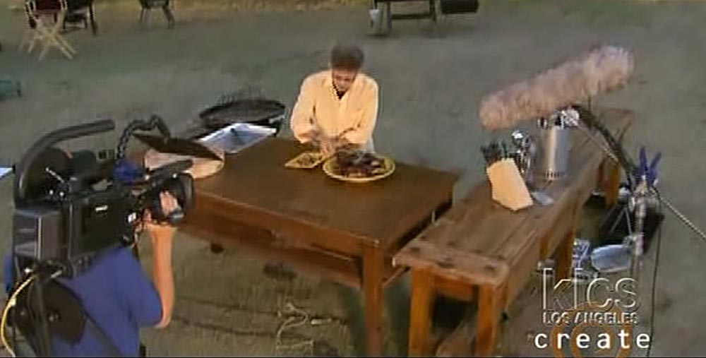

a good micro, with a professional camera
Like this?:
(The fuzzy microphone (dead cat) on the right.)
