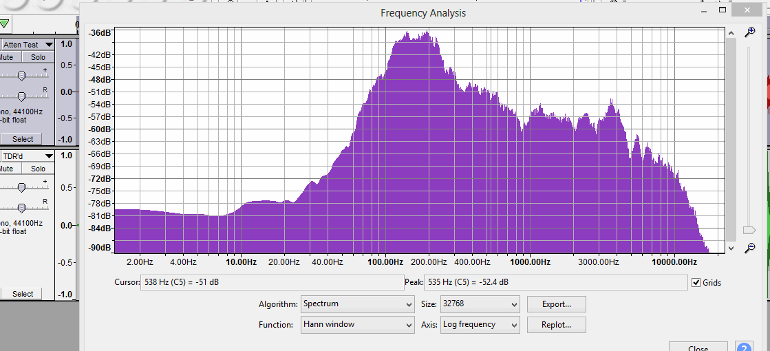

You’ve got that ~130Hz booth-resonance thing happening
The free version of TDR Nova can fix it …
https://audio.com/anonymous-audio/brian-blessed-david-attenborough-had-a-baby

The spectrum plot is not affected by headphones/speakers/hearing
You could learn from actual Attenborough recordings what his spectrum is.

Just a static dip in EQ at 130Hz* could suffice to reduce the booth resonance,
but the optimum solution is a dynamic dip at 130Hz* which responds to changes in volume.
This can be done with the free version of TDR Nova …
Even after attenuating the 130Hz* still need to EQ and de-ess
