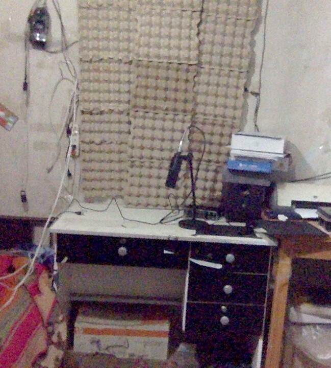

What I think is the echo is appearing because of post-production process. When I hear the raw recording there is no echo (as far as I can hear), of course the sound must be normalised since it is always so quiet when in raw. Also I like to compress it, and at the end I use noise reduction to fix any undesirable background noise (although I have a much quiet environment). I don’t know whether it can be considered as “highly processed”. I wonder if it is normal for an echo to appear because of these processes, I tried to vary the order of those, buy with no success. I attach a picture of the place I am recording, my room is 3.5mx3.5m.
Thanks for the illustration. You have the worst possible room. Not only does it have bare walls, but it’s square. You will have one strong echo going both directions.

I added some egg containers on the front wall.

A heavy ruched curtain would be better than egg cartons.
Curtain-fabric can be fire-retardant, not so egg cartons which are a fire-hazard.
But, if you decide to go with the egg cartons, you can do slightly better by making a curtain out of them and suspend them two or three inches away from the wall rather than nail them in place. They count as two independent sound barriers then instead of one. Not that I’ve ever done that or anything…
