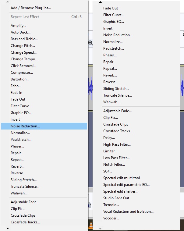

Well, I’m using the most recent version and while I see an option for NORMALIZE, I don’t see an RMS NORMALIZE option. Is this the same?
RMS normalize is different: it’s a plug-in you have to install into Audacity,

And I included the image, as it indicated the only Reduction option I see on drop-downs.
The hiss can be brought down to ACX levels with processing in Audcaity …

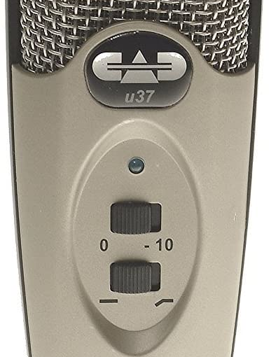

BTW …
Yep, mike is on ''0".

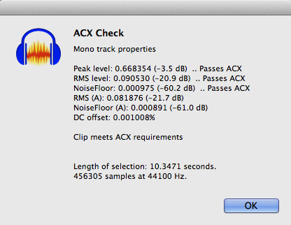

I applied the three tools in Audiobook Mastering…
… and the clip passes.
So you could stop right there. No other tools. However, you don’t pass noise by all that much and I would add very gentle noise reduction of the beast, 6, 6, 6.

The other mic switch isn’t compression, its a rumble-filter which cuts back the bass.
